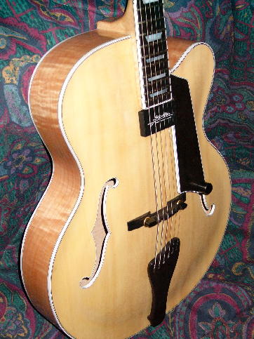

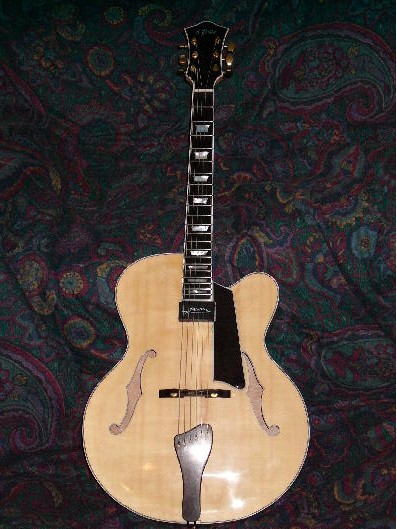

Here you go mon ami! Here's one I completed a couple of years ago.

Very, very beautiful, Anthony!
And the archtop is nice too.

Anthony! That is superb! Very very nice indeed... That maple is very stunning. I also like the natural colored finish. Not much tint, if any... Very tasteful.

What type of pickup is that, Anthony?

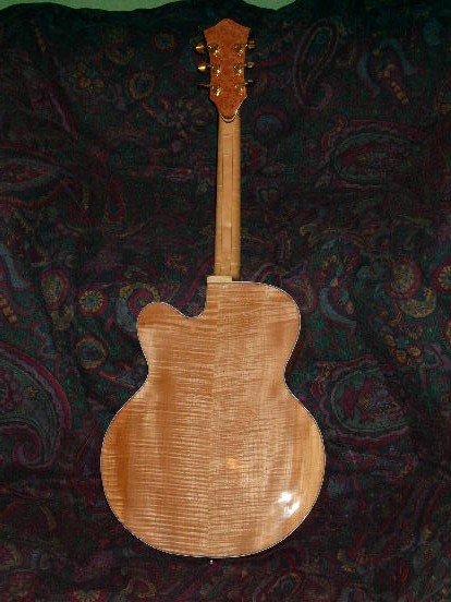

Very nice work, Anthony!
That headstock backstrap looks very elegant, it it burl? How about a few close ups?

Archtops get all the pretty girls! Nice work, Anthony! Thanks for posting. Is the bracing parallel or "X"?
PostPosted: Fri May 26, 2006 9:54 am
Hi guys and thanks for the comments and polite references to the model (I probably shouldn't have posted that pic).
I picked up this maple from guitarwood.ca and it was actually his lowest grade of figured maple.
Larry - carving the maple wasn't too bad as I use an angle grinder with a Lancelot blade followed by IBEX plane, scrappers
Arnt -- I'll try to get a photo of the backstrapping hopefully before this thread goes off the board. The backstrapping is B veneer/sycamore/B veneer/Maple burl
Nelson - the Pick-up is a floating Atilla Zoeller (I cut off the neck extension, laminated on a piece of aluminum with epoxy and then epoxied with a piece of carbon fibre cloth over top. I am not crazy about this pick-up in terms of sound. (BTW: You are an imp )
Alain - the tint is provided by blonde shellac from Lee Valley. It actually darkened the top more than you'd think as its Engelmann Spruce.
Carlton -- it is X braced

Ah Archtops -- they take easily twice as long to build, don't have the dynamic range of a good flattop, use three times as much top and back wood. On the plus side -- they are plenty loud, each string sings individually and more clearly than a flattop and dang they are pretty!Anthony Z38863.7953009259

Archtops I think are no different than flattops -- try to build them as light as you can. One thing that would really lighten up an Archtop would be to use mahogany for the neck. Maple necks sure are heavy (and figured maple can be a bear to carve).
I use willow for the neck and tail block in the tradition of violin builders. It's light and pretty strong.
